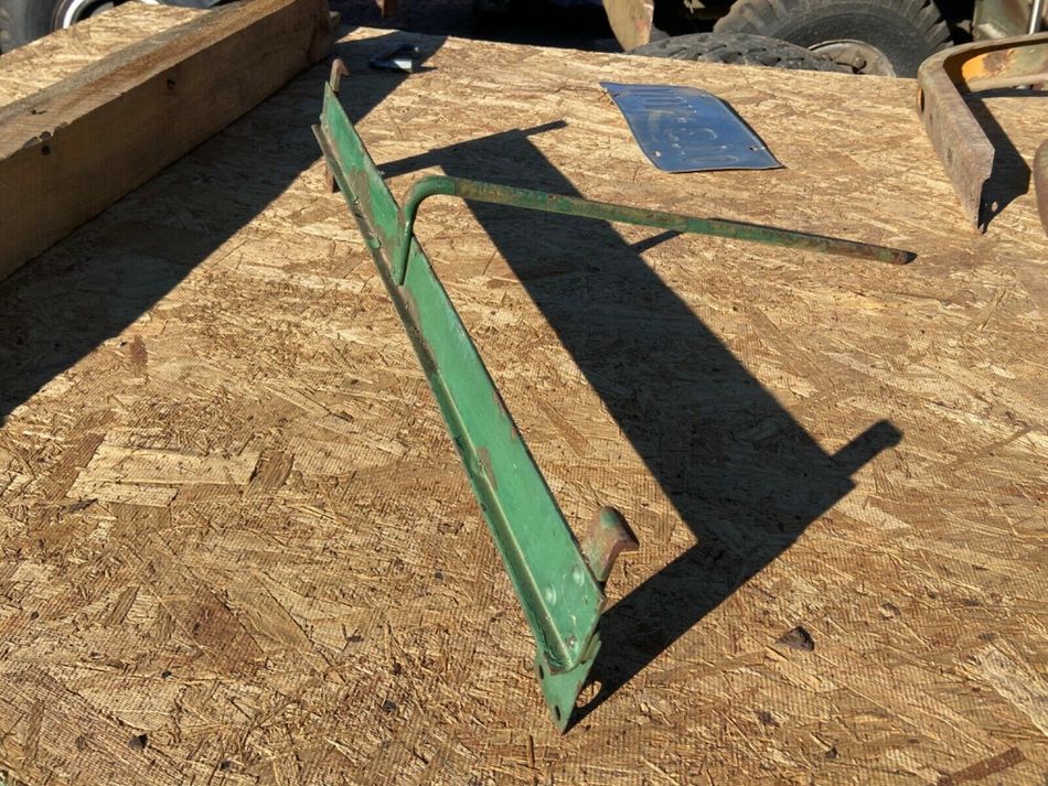

Like this?

Yes, that's the piece.
How is it attached? Is it on a hinge?
Are you able to post more close up photos?

There are no hinges. The movement is catered for by flexing of the thin spring steel plates that are riveted to each end of the cross bar and bolted to the seat riser with the twin bolt arrangement.

Ahh, I see...makes sense, acts as a hinge and keeps the locks engaged in the seat...
