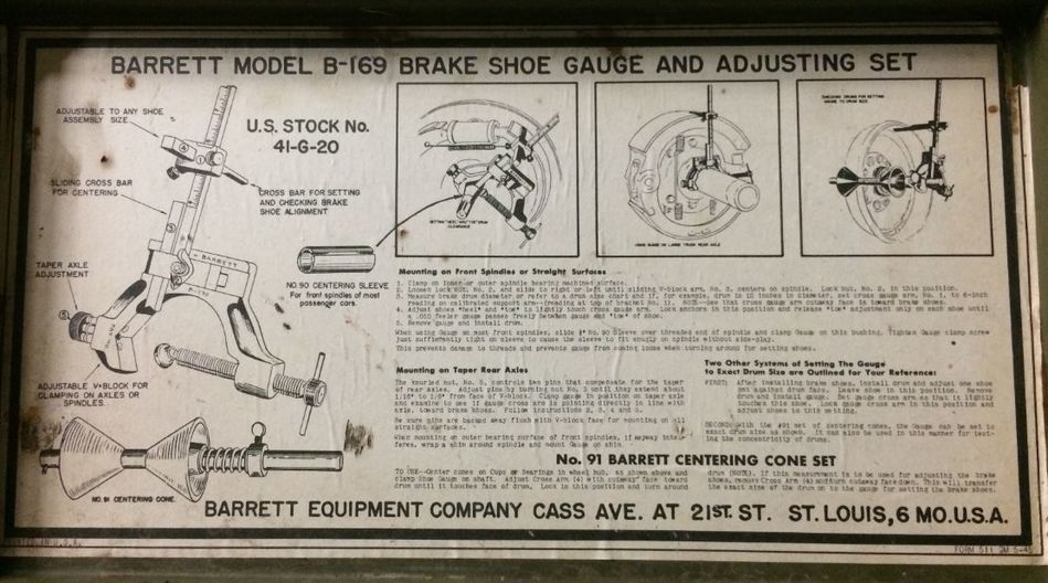

They used to make a set up tool for setting fixed anchor brake shoes but finding that tool may be impossible. i have seen a few that work on old cars but wont work on these axles. maybe drill or cut a window so you can set by the book?

I have one of those tools to set the brake shoes with the drums. Works pretty good. I like it. The part number of the one I have is in the second photo if one felt inclined to search for one. I see them pop up for sale from time to time. I found one that went at auction for $15. I had to pay $25 for this one:

Ok I see. I will mill slots as per original, faster than finding that neat tool.
