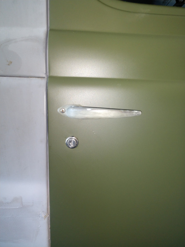

I had to drill out the broken/ seized lock screw and then I drilled & tapped the hole for a 12-24 size screw, original was 10-24. I read on another forum the Ford truck replacement locks would fit; it did after some massaging of the replacement lock cylinder, but for less than $30 I have a functioning door lock! Image

good job. one step closer

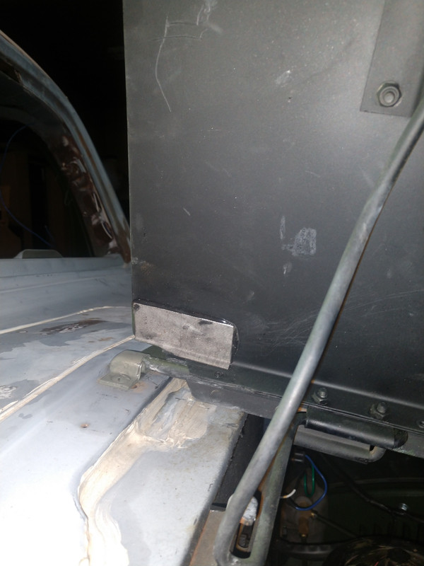

Hi Ian, re: the hood, I had to adjust the rods going to the radiator support. One side was adjusted too long, the other was too short..getting the nuts loose by the firewall was a pain but I finally got em done. Then I squared it up with a tape measure. Also, I had problems with the reproduction hood hinge clips. They caused the hood to bind and bend the pass side corners up...so I had to trim a small amount from the hood for clearance (about 1/16th), then I added some reinforcement pieces under the passenger side hood corners, next to the hinge. Since the hood was already painted I used body panel adhesive, instead of welding. It’s a work in progress, I still think the hood could fit better.
The original hinge clips also must have caused some binding because I did have to fix some original damage/cracks.
