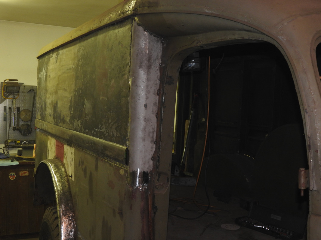

On the driver's side I was able to make a cut where the remains of the original panel and the patch panel overlapped and then did a butt weld to join the patch panel to the original wall. Where the sheet metal screws had been used to hold the patch panel in place I removed the screws and filled in with weld to simulate the spot welds.

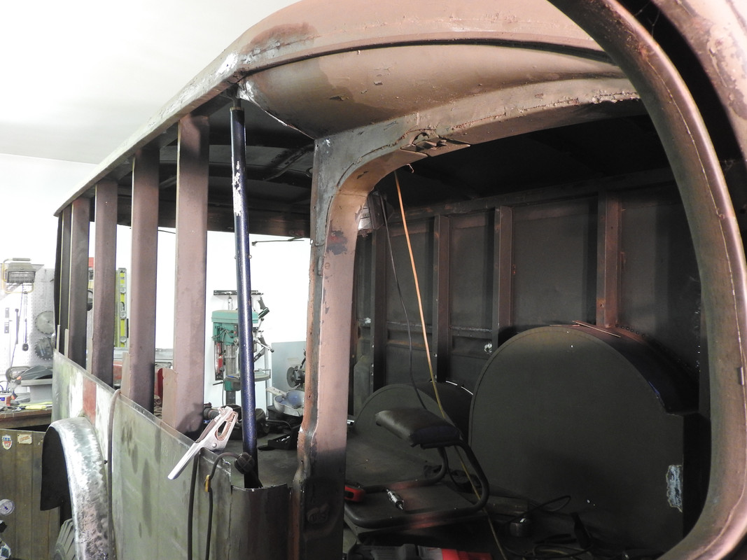

On the passenger side I wasn't able to do the same as there was rust through on a section of the original wall. I ended up drilling out all the spot welds below the rib, removed the remains of the original wall above that, and then fit in a replacement panel from a donor ambulance that was headed for the scrapyard. I also had to replace the upper portion of the front corner as the replacement panel wouldn't sit flush against the original corner.

Here is the passenger side after shot.
