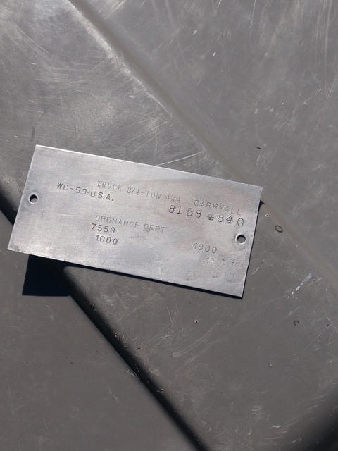

I cleaned up my glove box data tag using an electrolytic derusting process; it was kind of rusty in spots, but came out very clean. Some of the numbers were very lightly stamped and I am thinking about just clear coating it because paint will probably hide some of the faint numbers; besides the other data tags are/will be unpainted.
The other tags on my glove box door were missing so I looked at the manual to see what else should be there... the manual shows the I.d. Data tag on the lower left side of the door, but mine was on the top right. Still riveted into place... at least the numbers match. Was there a production change regarding the tag placement?

There was some variation, certainly.
The manuals show the tag locations on the very early trucks or prototypes, and some of those illustrations were of the civilian trucks too. If you have the original stick with that layout and you can't go wrong, though I'd guess one got rearranged, rebuild tags, and so on over the years.
Main chassis number tag was always riveted, so if those rivets haven't been disturbed you are good.
